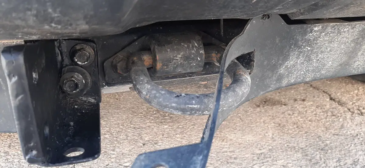

It means that if the engine ain't running you cant pull for a long time or you will cook your transmission. Cant drop the drive shafts on these things. There is a way to wire it so the transfer case disables and you can tow without fluid pumping through the transmission. Ford used to sell a kit but its long gone.
