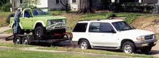

2800lbs is a joke... even for the V6er... if you are only towning short distances you wont have any issues towing off of the bumper. i tow this setup alot...
