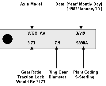

I have a 95 xlt. I look at the sticker on the driver door and the axle code says: 45. I look in the manual for that code and it is not even one of the possiblities - so I am having trouble finding out my rear axle ratio. I want to tow a camper trailer. It is 4250 lbs. If I have a 3.55 ratio I can not tow it. If I have a 3.73 ratio it appears that I can. Can someone help me with this. I have tried searching the forum, web sites and calling the dealer - all fail to answer this adequately and I am getting different answers from different sources.
Finally, I am thinking that adding a towing package could help. Is that possible to do after market and what would be the approximate cost?
For your axle ratio look at the tags attached to the front and rear differential covers,
Thank you
I decided to play it safe and assume the lower ratio (I may have found it referenced somewhere). But your post is good info for anyone else who finds an axle code on the driver side door sticker that is not referenced in the manual - do directly to the differential and get it.
Thank you
I hope this helps you out.
