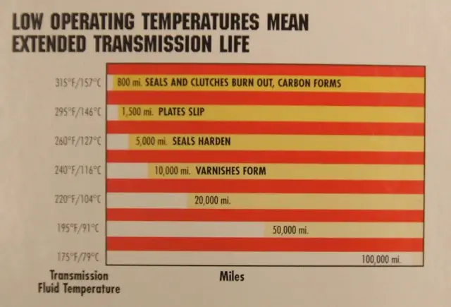

One other point, I boat as well, and I will say that boat ramps will wreak havoc on your tranny. You are basically asking your truck to slowly climb a steep incline which basically spins the transmission the whole way. This creates a lot of heat fast. If you don't remove this heat you can quickly burn your transmission fluid and, as the chart above says, burn up tranny parts...

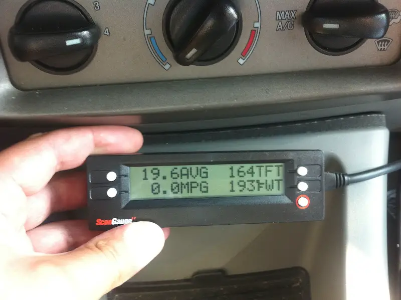

I think there is a sensor in the transmission for temp
I use my scangauge2 to get it
i have it showing my average MPGs, MPG, Transmission Fluid Temperature (deg F), coolent temp.
After flushing my tranz good (see link below) i wanted to see what temp it runs at with out adding a temp sensor. the scangauge did that for me
http://www.explorerforum.com/forums/showthread.php?t=278945
for all the people towing i think its money well spent
Maybe in the newer models, now you got me thinking I missed it. I'm going to go hook up my laptop to my truck and browse the sensors to see whats available.
My st is a 2003 and u can see from the pic it def has it. Not sure about years befor tho
Wow that thing looks pretty nice, I've done a lot of reading and never heard of anyone using that to monitor transmission fluid temps.
After browsing their website it looks like you need the "ScanGaugeII with X-Gauge" to get the trans readings. The standard scangaugeII won't do it.
I'm definitely gonna try to get one of those!

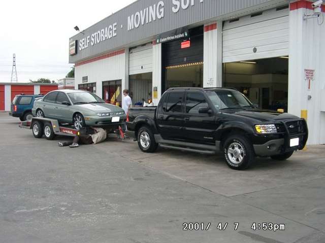

You managed to get uHaul to rent you a trailer??
They wont touch explorers but the sports must be ok? :D
Check the date on the photo. That's before they implemented their famous Explorer ban policy.
