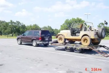

I tow a Jeep on a tandom trailer with my SOHC V6 with no problems.
Good luck .....

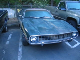

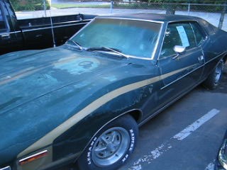

But I actually might be getting the Javelin soon. If I do buy it I won't have it for long though. It has been sitting at my dad's work for sometime now and is going to waste. :( I have a friend that is getting his license soon and would like this, but there is no way his dad would buy him a car that looks like this. Although it looks like crap now because of the paint, it actually ran really well a while back when they began restoring it. If I spend about $750, have it painted, and give it one of my wonderful detailing jobs :D, I know I could get a decent amount of money from this. Other than the paint and one dent, the body is in pretty nice condition. I've been looking at some 72-73 Javelins went for $5000-$6000 when the interior was only in decent shape and the paint was horrible, but they ran well. I can get it cheap so I think it would be a good investment, and then when I sell it, I will have a decent amount of money for my new project *cough* *cough* SAS ;)
Here's a couple of pics:
