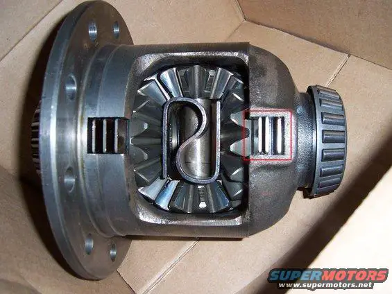

If you have the cover off you should see the clutch pack. However look at the axle tag. If it says 373L then you have the LS diff. Everyone of the UK explorers that I have seen have a 373L diff.

If you see an "S" spring, then you have a Limited Slip differential.
The cluch pack mentioned by Howard is boxed in red.
