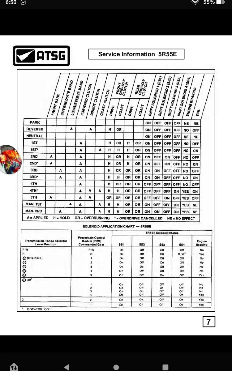

5rr55e. Have to manually shift from 1st to 2nd but going to drive rpms go up, have to push OD off,then it goes on to 3rd and 4th but then rpms go up then push OD again and it seems to settle out. Is this a specific OD problem that I could possibly fix even cheap. Any help out there?

manual 1/2 but no drive= VB work to me. not hard imo, many companies like sonnax transgo superior make kits for these
1/2M uses different servo iirc. the sporadic OD sounds like soemthing involved in the OD shift (servo or soemthing) is going out, as 2nd is a combo of 1st and od, so that could explain maybe it shifting to 3rd? not sure, does anyone know if OD is off it will skip 2nd?
TLDR: VB issue, should be fixable. shift kits/fixes available
Sounds like a broken Intermediate band
but it manually goes into 2 though, and also goes into OD at times. is there something im missing/knowledge i dont have? want to learn from the greats!
I've just seen this on the forums a bunch of times over the years
These symptoms always end up being a broken band
a flair shift would be more of a valve body or solenoid Issue
Or A mard up server bore

oh ok! didnt know that, thanks!!!!! always helps to learn from members with way more experience!

Band adjustment or servo failure/failing
