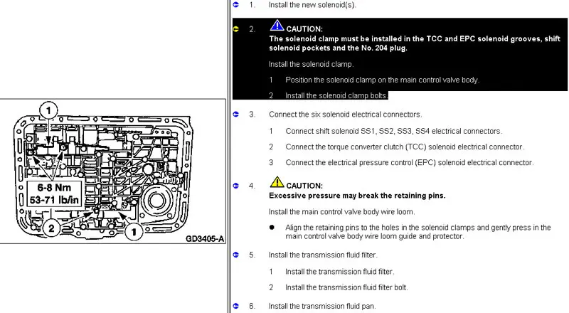

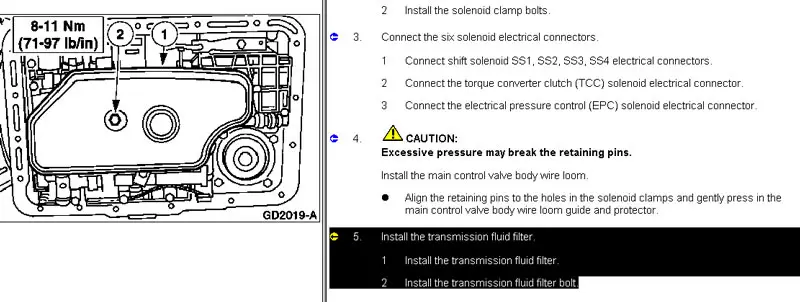

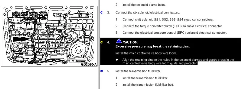

Search for shift solenoids. I think there was a TSB out on that. Replacing the SS is easy as long as you have basic hand tools and can drop the tranny pan.

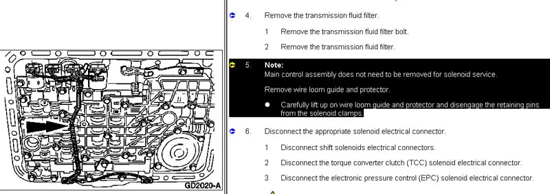

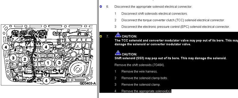

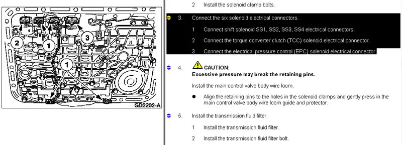

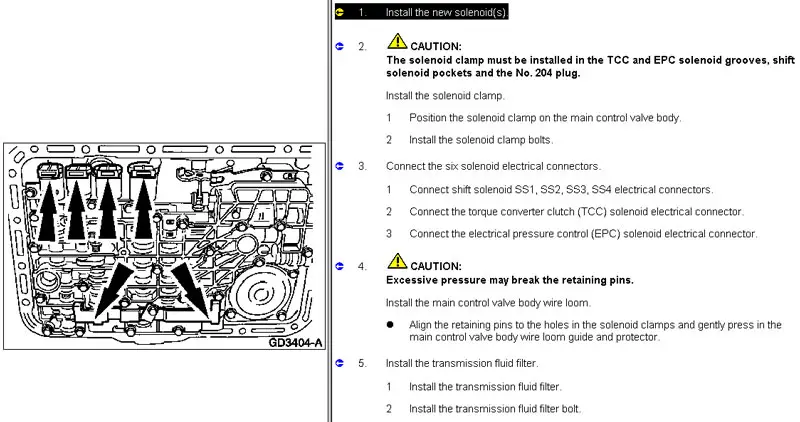

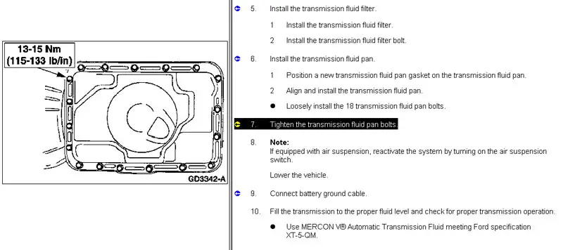

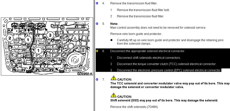

I have the procedure to change out the solenoids for a 5R55E. Your tranny is slightly different, but this will give you some idea of what you need to do (They forgot to tell you to remove the pan, but its pretty obvious from the pics) ;)
ss2
ss3
ss4
ss5
ss6
