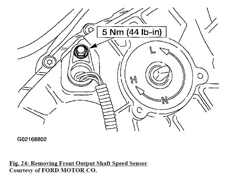

Just so I am clear about this, does anyone know if there any actual physical differences between the two cases, so that if I swap the shift motor and wiring from the original case to the replacement it will work properly? Also you refer to the speed sensors on the two cases. Are you referring to the small sensor which has wires leading to it from the connector? The orig case has this feature but the replacement case has a single wire going to the ?sensor. More info, the replacement case has nine pins in the plug and the orig has fifteen pins. Also, I do not have any speed sensors on the rear wheels so I don't think the truck is equipped with traction control. I am so confused!!!! I thought this would be a simple swap type R&R, NOT. Thanks in advance for any input/help.
Are you referring to the small sensor which has wires leading to it from the connector? The orig case has this feature but the replacement case has a single wire going to the ?sensor. More info, the replacement case has nine pins in the plug and the orig has fifteen pins. .
YES ... I was refering to the Front Output Shaft Sensor located behind the shift motor ...
And the Rear Output Shaft Sensor located under the rear output shaft ...
I'd imagine if both the transfer cases you have in front of you are physically the same then swapping over the ancillary components (shift motor, sensors & harness) from your old unit onto the replacement has a high degree of probability of success provided that where the sensors are 'sensing' ... that the appropriate shutter wheel is indeed on the shafts inside ?

On further investigation I have discovered that the two cases are not physically identical. The replacemant not have a front output shaft sensor. Cursory examination was not sufficient to see this at the wrecking yard. I guess I am screwed and will have to find a second replacement. I am left wondering exactly what case I have. I was told it came from an 02 Explorer and took it a bit on faith that it would be a direct replacement. Do you happen to know if I can salvage the situation without buying a second replacement.
Okay ... so if you really are stuck with this other transfer case & can't return it ... If it were me, I'd be seeing if I could remove the rear cover off the replacement transfer case & swap it with the rear case from your original transfer case ... provided it phyically fits & that the 'shutter wheel' that the sensors read actually exists on both the front output & rear output shafts of the replacement one ... it may just be a bolt in solution ???
