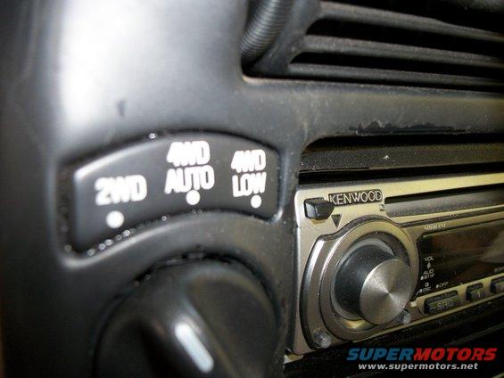

ok i have a 95 x sport 4.0 ohv and auto tranny 4x4 with a tcase that shows 2wd,4hi(auto) and 4lo.tcase works great,truck is alittle rough.i just bought a 1998 4.0 sohc and auto tranny 4x4 with a tcase that is bad but it is ... auto,4hi,4lo...can i swap the 95's in with no problems?
both cases say they are 4405's.the 98 has a flange style yoke and the 95 has a ujoint stlye yoke.
heres is the 95's 4wd selector......
this is the 98's...
Yes, the 95 case should work in the 98. You need to use the 95 front drive shaft. The 95 case will have a VSS thats not used in the 98. Just leave it in the case (to keep it sealed), and ignore it.
