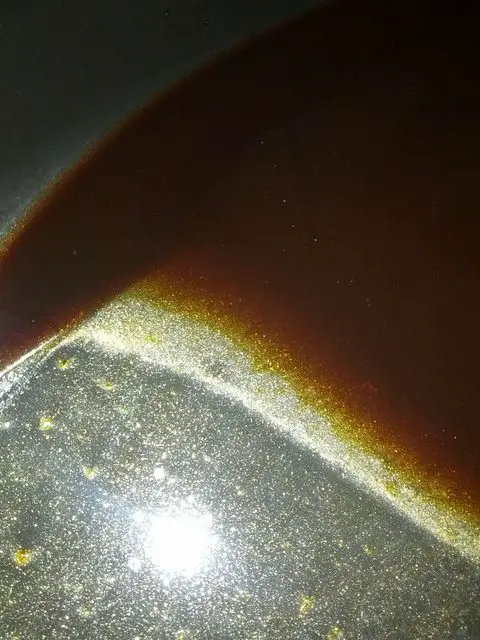

Hello,
I have been having some occasional loud clunks and clicking noises in my drivetrain that I'm pretty sure now is the transfer case. The "clunk" noise is similar to what happpens sometimes when switching into 4-low, but louder. Here is what I found in the oil when I changed It:
Notice the glittery metallic layer that settled over night.
And later I found this:
Chunks of a non-steel (i.e. my magnet wont stick to it) metal about the size of a BB (I think the other thing is just a stray rock) there were lots of smaller chunks too I didn't photograph. Also, the fluid I recovered was about half of what should have been in there.
So would you guys say that I'm probably on the right track with the transfer case? I'm going with that assumption and heading to the junkyard tomorrow that has a few 95 and 96's. I am pretty sure I am looking for a BW44-05.

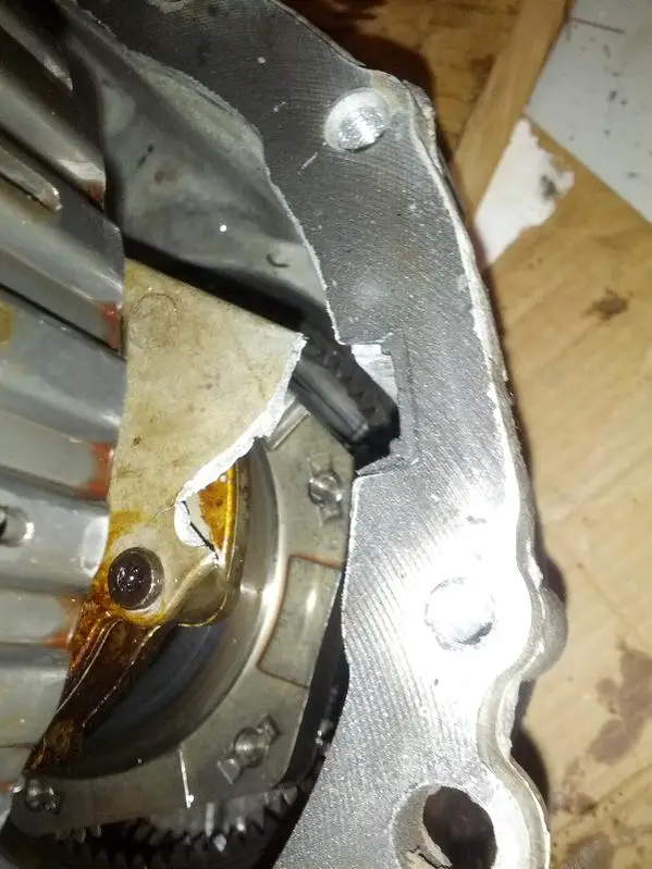

Yep, it was the transfer case. Specifically the oil pump. Take a look:
I believe what happened is the retention tab broke and started spinning sometimes (the occasional thump thump thump was possibly the tube spinning around.)
EDIT: The real question is why the tab broke. The oil pump seems stuck rotating with the output shaft. I assume it rides on a bearing that went bad?
So I'm not sure what else might be affected, but everything else looks fine (once the shredded metal is removed.) It's a shame because I don't really want to spend money fixing it but don't really want to throw it away either. I'll probably clean it up and hold onto it in case the junkyard part craps out.
