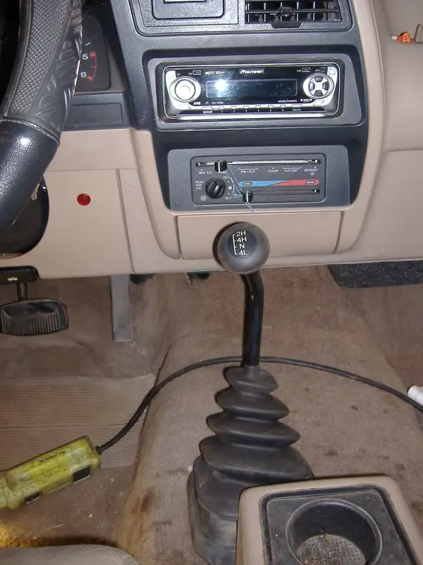

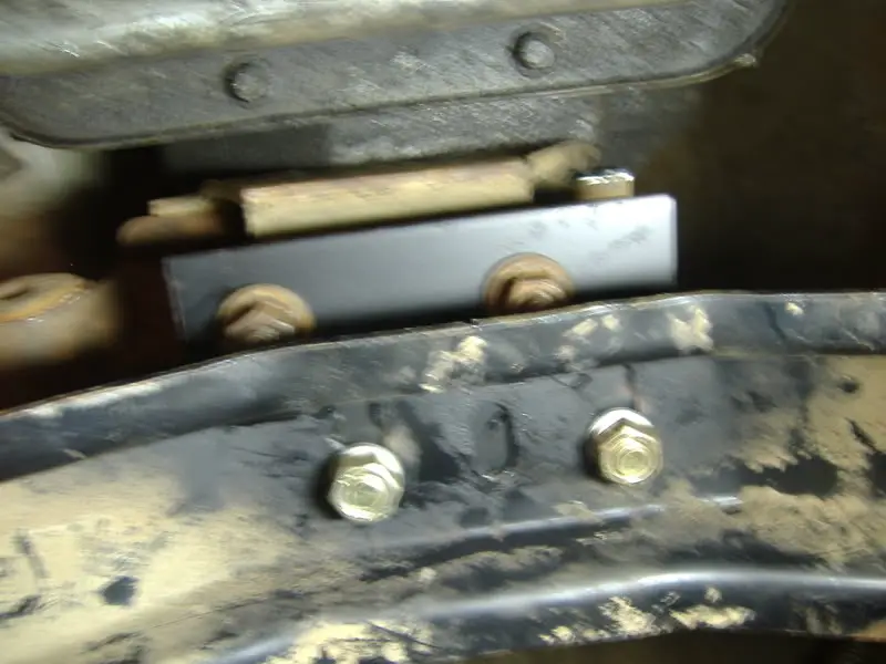

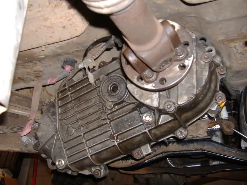

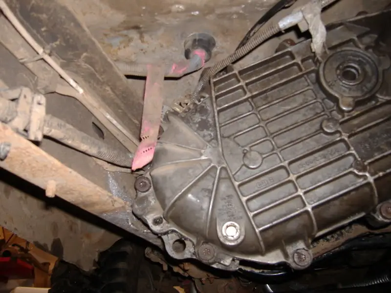

I have a 351 pushing a 4r70w and 1356 BW xfer case
1) I used a front driveshaft from a '97 up F150 w/4.6 engine
2) rear shaft was shortened 1.5"
3) tranny mount was moved to passenger side about 1" to clear drivers frame rail
4) tranny mount was also move forward about 2"
5) I already had 2" body lift for engine which is almost mandatory for xfer case unless well beaten=hammer
My case is from a '90 Bronco with rear flange (no slip yoke)and is manual shift. I had to drill and tap the xfercase flange to the smaller Explorer driveshaft flange diameter bolt holes-easy.
I love this setup as I now have a strong driveline built from the factory for fullsize truck use.
