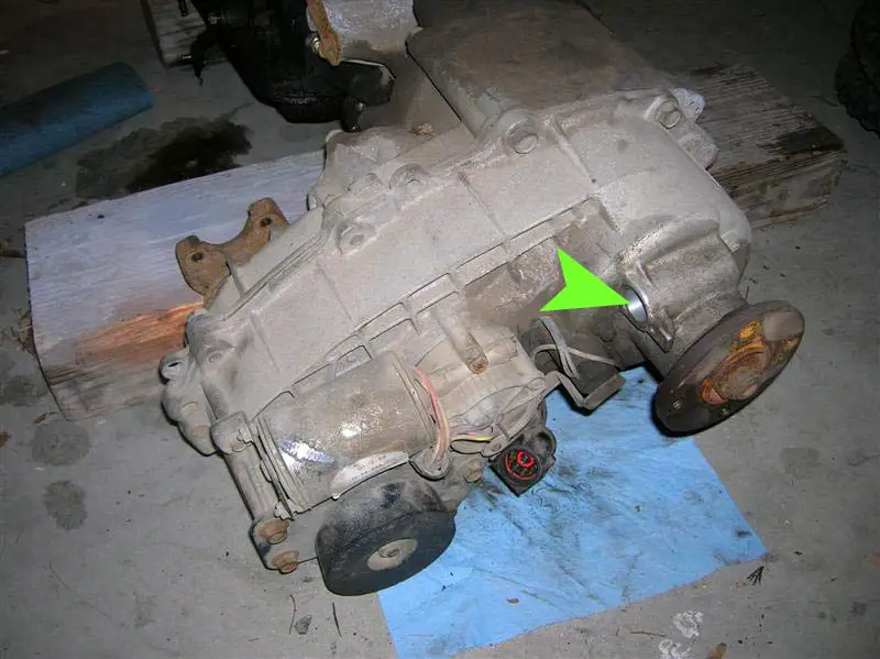

Thanks for the pics. I'm still stumped. I took some pics of my old tranny and if you could just tell me where it plugs into i'd love it. The only have about 1.5ft of wire where it comes off the frame so i can't go much farther than the transfer case, and there is nothing to plug into there. Does this plug into the transmission or another wire somewhere?

Might be your transfer case -- looks like its missing a rear VSS sensor (see attached image at the bottom for sensor location).
The sensor looks like this:
