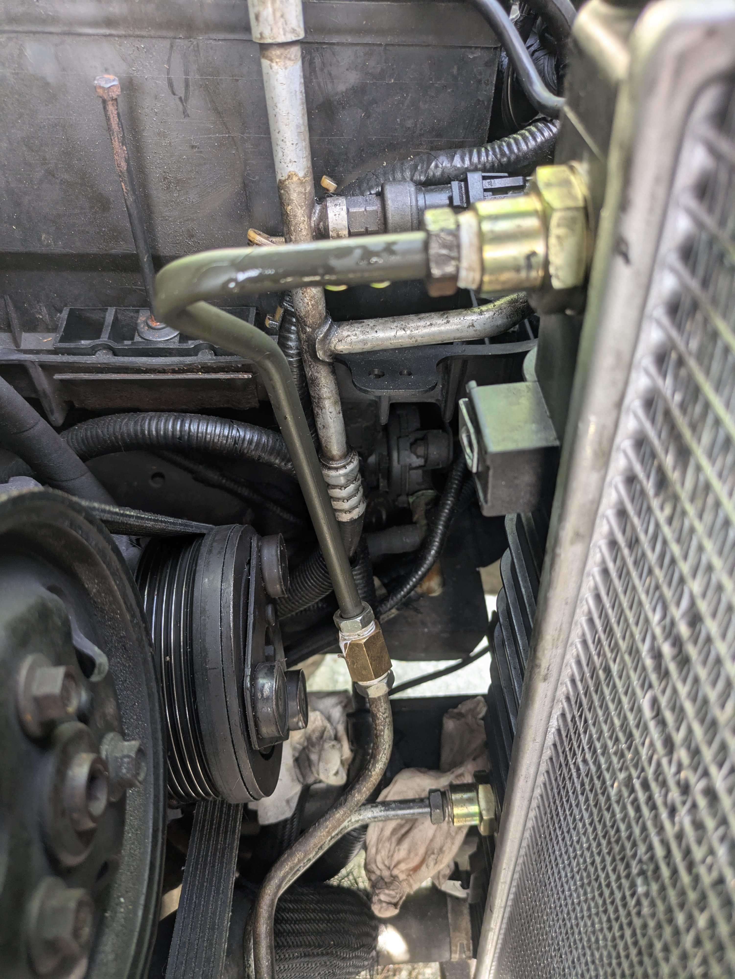

Prior owner snapped the pressure line (trans to radiator, upper) when doing the radiator, 3/8" tubing. I figured no big deal, except the line flaring tools don't seem to be able to flare the steel (stainless?) original line or new replacement parts store end I bent to replace it. It looks like the factory tacked it together with the return line that comes from the cooler back to the transmission, with a mounting bracket.
Is there a better way to flare and put fittings on the steel lines? (I am willing to admit not doing it right, granted it's not a complicated process, or having the right tools.)
Am I going junkyard shopping?
Would a 4.0L pressure line work? (ie Doorman 624-268) I'm not sure how similar the 4R70W and 5R55E are, or how close the radiators are.

Been busy, but I discovered that you have to commit a little tool abuse to get it to hold the line without slipping. Broke the first tool with one flare left to go, replaced it and finished. Ran out of time to make sure it doesn't leak, but I have a bunch of stuff to test next weekend anyways, and I need to pick up some ATF to top off what was lost. If all goes well, I should have the tag transferred and the current daily parked by the end of the month.
I took the fan and shroud off to do the last flare. I just put that fan on so I'm not sure why it fought so hard. But yeah, figured I'd update.
I cut it down where I did because the line had been kinked a little in addition to being torn in half up near the end. Where it was torn didn't have enough space to get the tool on it to flare either.
