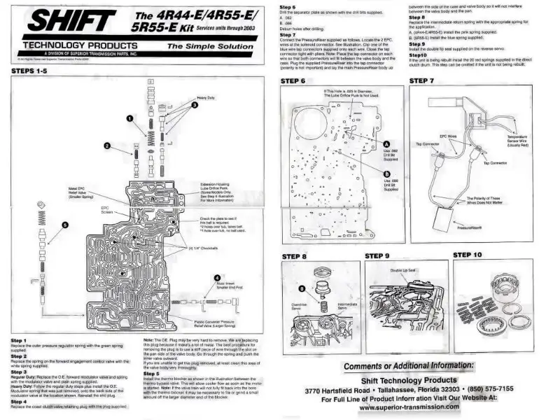

Thanks for the quick reply - how hard was it to put that shift kit in?
I used the Superior kit, it was fairly simple to install, although a couple of steps are done as part of transmission rebuild, so if you are only working from underneath the truck, steps 8 & 10 are omitted. It is mostly just changing springs & valves.
I cannot say whether or not the kit is worthwhile if you are going to use a VB from Central Valve Bodies, but I'm sure they could answer that question for you.

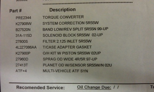

I had mine rebuilt and from the looks of the parts list Idk if the vb was touched (most of problems)
Correct me if I'm wrong but I don't see any vb work by lookin at parts list.... Thanks
Explorer transmission rebuild parts list by billyssingle, on Flickr
My warranty is basically gone but I'd bet I can make him fixit if he missed a critical fix...
It was (and I swear still is) sending burnt fluid to converter thus killing it (3 in 100 k)no towing grandma owned.....
My buddy is trying to get me to rebuild his 02 x tranny... Only piece of a car I haven't touched...I figure learn on his so when mine goes again I can fix it myself...
