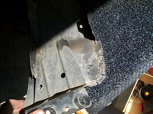

i know its obvious how to trim, but im looking for pics of it done or a link to some pics. i want to do the best job i can. i already trimmed the front plastic rocker piece and it looks great and drivable now. but i still rub slightly on the black inner fender plastic and on the passenger side im hitting the metal part of the fender where it bends under. im looking for all kinds of advise but mainly cosmetically how to do it the best. and 1 question is it normal to have to trim this much ive seen lotsa trucks on here with 33's but maybe i didnt take into consideration that they trimmed alot. thanks
Hey Red.. when I trimmed mine this is what I did.
I drew a line with a sharpie the rough round I wanted to trim. Then cut slots from the outside of the fender to just before the line. Then I just folded the tabs back ever so gently. :D
I used a die-cutter to do this, by the way.
Here is a pic:

cut and bend i like it glad i waited now thanks is a die cutter something like a dremmel tool with a cutting blade?
