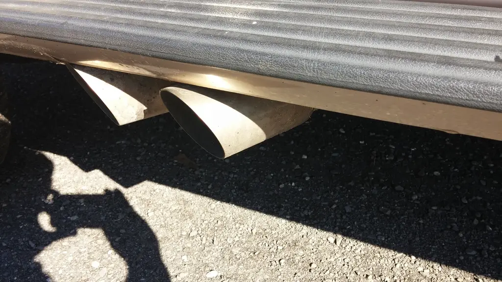

Technically you're not supposed to exit an exhaust system near the passenger compartment. That being said my 99 is a side exit in front of the rear tire and it's badass lol. Oh and by the way I never smell any fumes whatsoever in my truck the way my exhaust is.

I miss-read your post and thought you wanted to put the pipe on the drivers side, not the passenger. You can fit 2 mufflers there all day, I have 2 mufflers there with side exits on my 5.0 ranger. They exit about 3 feet behind my passenger window. Its state law here in Va that the exhaust has to exit behind the passenger compartment.
Exhuast gases float upward and with side pipes on an explorer you will have gases going right by your passenger rear window. You are playing with carbon monoxide, choose the exit location wisely.
