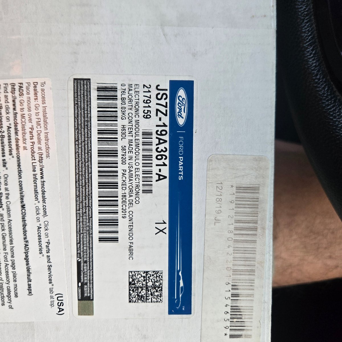

I bought the ForScan 1 yr license for $13 and downloaded the latest version. I purchased the ForScan recommended OBD link EX for $49. I then went to Tasca and ford parts giant, looking for the perimeter plus security module with remote start and purchased JS7Z-19A361-A.
After installing the module ( leaving the VSS jumper out ) I went into ForScan looking to find the new module. I've looked everywhere, APIM, BdyCM, etc and the module does not show up. I was able to ENABLE remote start, remote start parking lights, perimeter security, etc. Still no module found using ForScan. I figured I'd disconnect the negative cable for 30 mins then reconnect thinking it would then see the new module, nope.

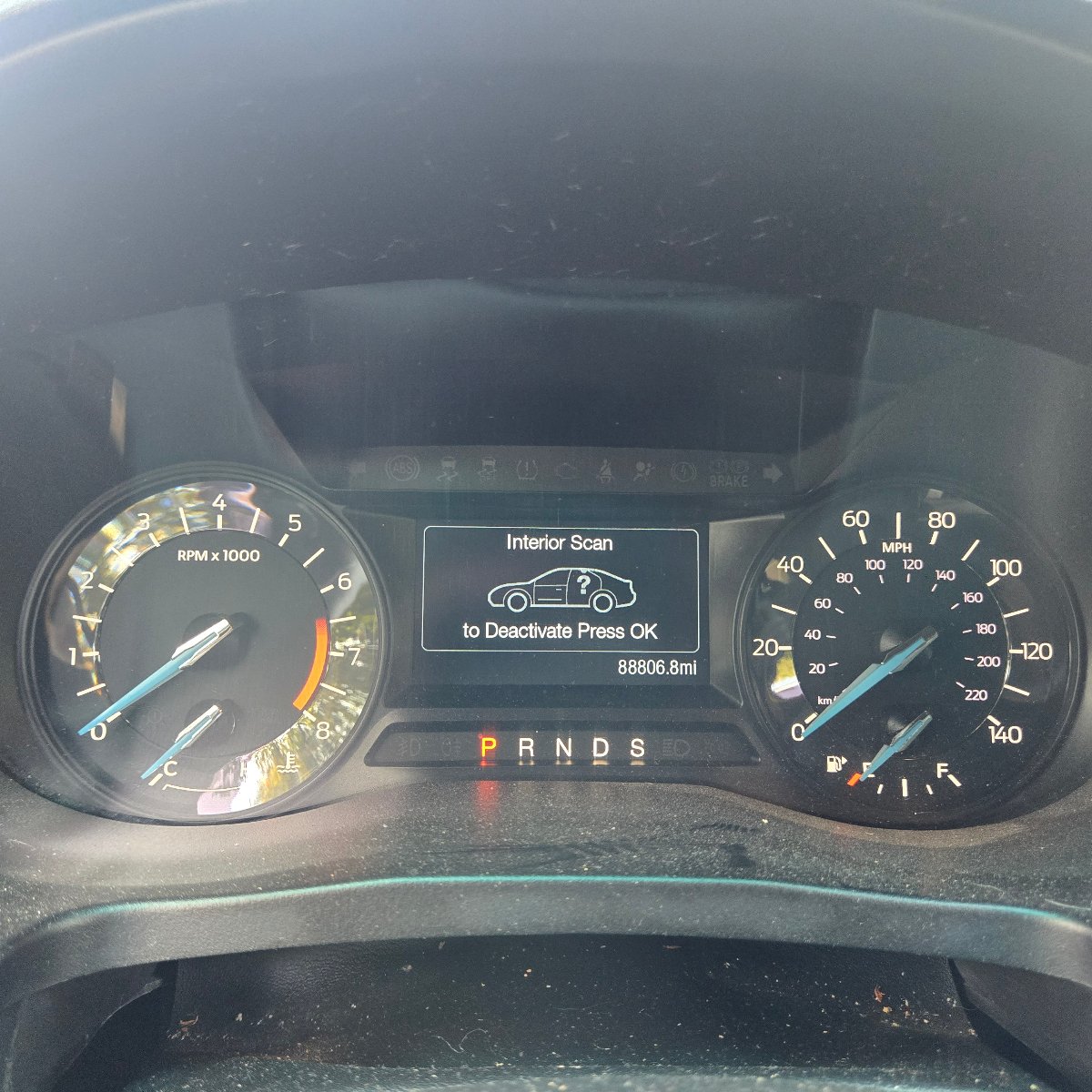

When I disconnected ForScan and turned off the vehicle my display showed interior scan to deactivate press ok. I've never seen this msg in 90K miles, so I figured it must be seeing the module.

Original keys, new FOB's, security plus module installed, module packaging and dash msg
