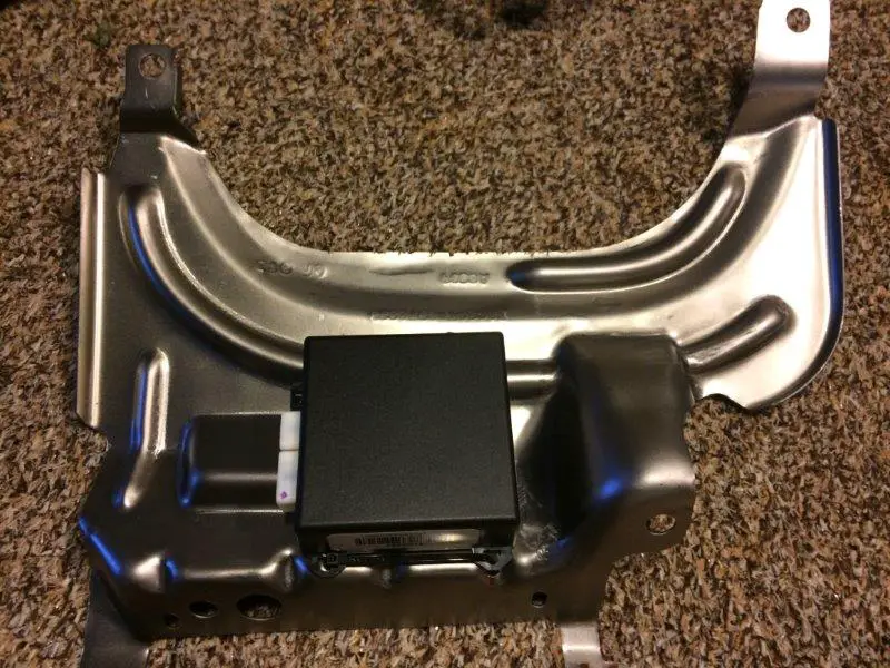

The 2016 Explorer not only has styling changes but the entire electrical system of the vehicle was changed from the standard used in the 2011-2015.
If your 2016 Explorer did NOT come with remote start from the factory, then hardware kits must be installed. They are plug and play which means no splicing of wiring.
You will have three choices:
1000' Long Range One Way System - Separate Remote Start Only FOB - Kit with Antenna and Two FOBs: EL3Z-19G364-B
1000' Long Range Two Way System - Separate Remote Start Only FOB
Cell Phone Kit known as "Remote Access" - RMU Only: DL3Z-19A390-B
Hood Switch (BT4Z-19G366-A) + Wiring Harness (DG1Z-14B504-A) is required for Base Model Explorers.
All three off these also require the VSS (Vehicle Security System) module which includes a shock sensor that can be disabled if you wish.
VSS Kit: FT4Z-19A361-A
Installation of a kit should take roughly an hour. This includes the IDS (dealer software) programming that must be done.
IF YOU HAVE A BASE MODEL YOU MAY NEED TO INSTALL THE HOOD SWITCH ALONG WITH THE HOOD SWITCH WIRING. You will need to check to see if these are present in the vehicle. A Police Interceptor Utility ordered without the perimeter alarm will have the hood switch wiring but not the hood switch.
People are going to ask why can't I have remote start enabled and get a new FOB with the remote start button on it like the 2011-2015 models. Well the reason is how Ford has setup the remote start in the 2016 Explorer. Without remote start the FOBs work on 315mhz (North America) and with remote start the FOBs operate on 902mhz.
I will update this with part numbers as I get them.
DEALER PROGRAMMING IS REQUIRED TO ENABLE REMOTE START.
Please note the above information is for ADDING remote start to your base or XLT Explorer.
If you have a 16 Explorer that already has existing remote start and you want to add a long range or cellular kit you can do that. As long as you have the perimeter alarm the only reason to contact a dealer would be to activate the cellular kit after you have it installed. They can do this without having possession of the vehicle. The only reason the dealer would have to have physical possession of the vehicle is to enable the remote start and perimeter alarm functions which if already equipped don't need to be done over. The kits do not come with installation instructions so if you purchase a kit on line ask for the instructions from the seller.
