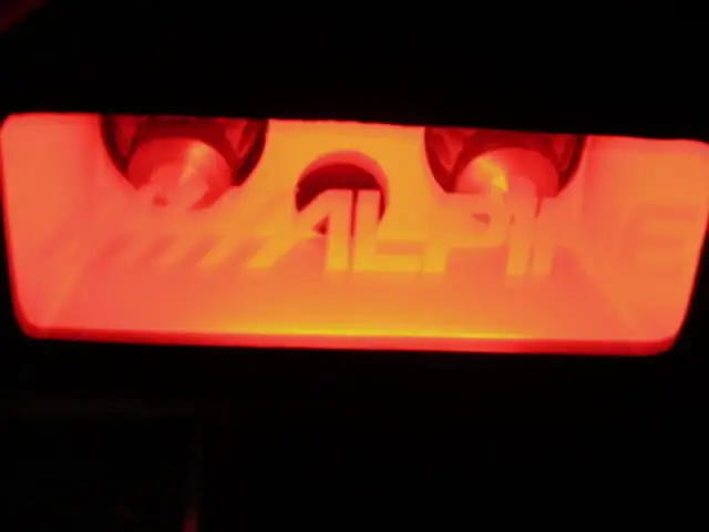

the box pictured was made by me. Was for a 95 civic sedan for two type R 12s. Was 3.5 cubic feet tuned to 34 hz using 2 4" aeroports (not installed in this pic) then had a 3/4" plexi window as the whole back of the box with the alpine logo sandblasted into the plexi. came out nice and sounded pretty good.
