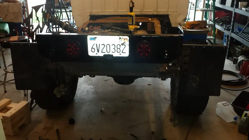

Here is the bumper.

There should be three wires going to each light, correct?
One ground, one lights, and one signal/brake.
Try switching the wires around, they might be reversed on one side or wired wrong internally (Harbor Freight).
