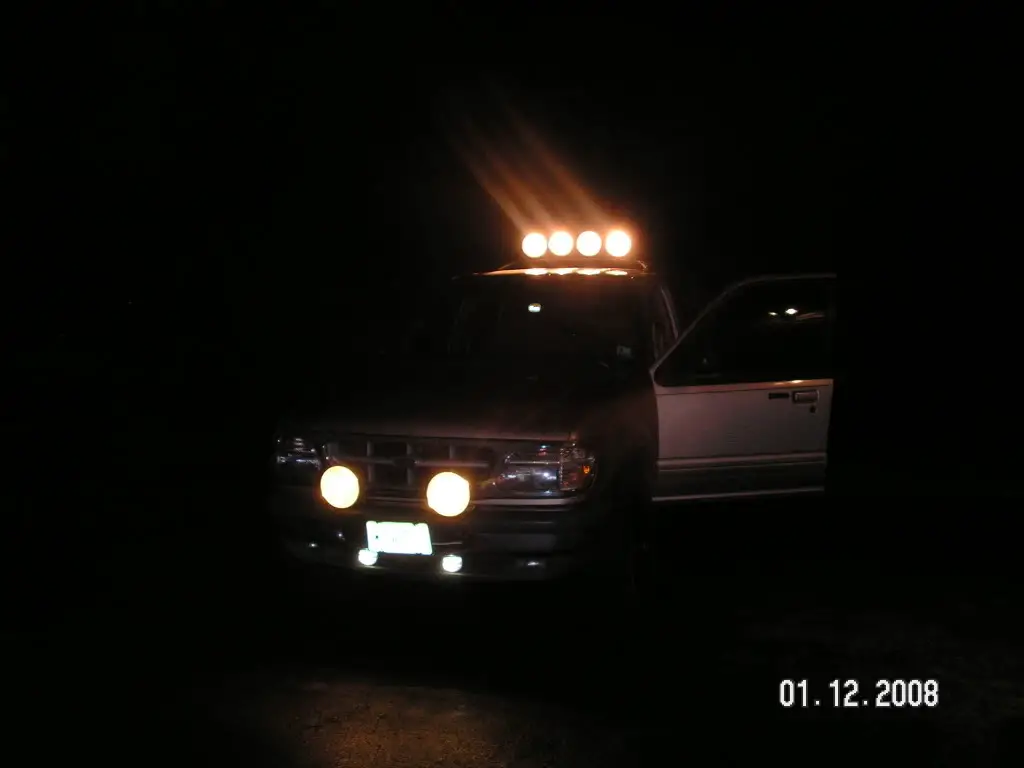

You never took any night pics...
Sorry, Something came up right before school started and now im back at school. Here are some older night pics though. Maybe they will help for now.. Sorry about that.

i like that pic with all the lights on. what bulbs are you using in your head lights? i like how white they are. can you see better with them than regular bulbs?
Those headlights look like HIDs to me, probably ... I'm gonna say... uhm... 4300K?
2nd guess... 5000K
Might be 6000k.. which is the same as I have.. and he took the picture after they've warmed up. idk... Definitely HIDs though.
I actually think they are 8000K warmed up for a little. I can see better with them, but they are single stage so there is no high beam, but I use my aux lights as high beams. I am probably selling them though, I am going to try a different approach and I kinda need money now ha.
