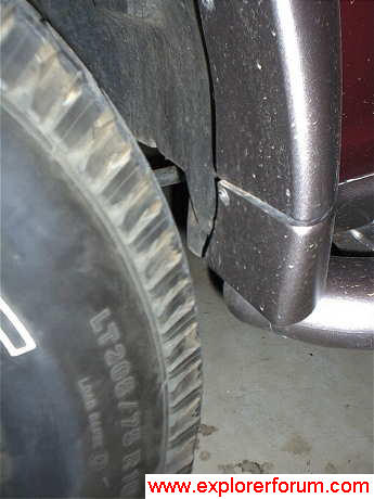

The only trimming I had to do on my '97 Sport when I put my 265 75R16 tires (31.7"X10.4") was what you see below.
