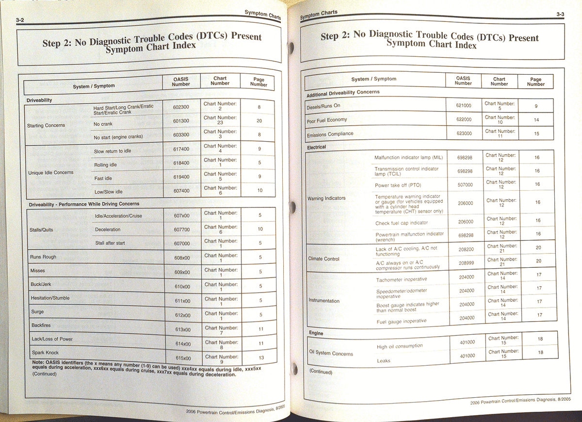

My 2006 Ford Car/Truck Powertrain Control/Emissions Diagnosis Service Manual has arrived, and it's a beauty! About $25.00 with shipping, and it looks like it's never been opened. Unfortunately, being in print form instead of PDF, makes it a pain to capture images of the pages. Too cumbersome to scan and taking pictures is no picnic either. Here's what I end up with:
Wading through this 2-1/2" thick book is the other issue. No way to search like a PDF. Maybe it will get easier as I use it, but it may take me a little while to find the correct Ignition and Fuel diagnosis pages...
Ok, I've figured out a little easier way to shoot the pages, and figured out how to navigate through it. See if the No Start info in the following pages gets you headed in the right direction:
Let me know if you need to branch into another section.
I included images of all the Pinpoint Test Contents, so you'd have an idea of what is covered.
