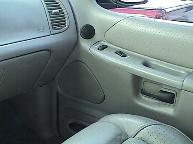

Here is what I did...
That looks great! I was also studying that location but I was thinking there was too much curvature to get it fluch mounted in that spot.
That portion of the door panel on my driver's side is shaped differently though(due to the power side view mirror switch?). Not sure if your x is the same. I don't suppose you have a pic of the spot you mounted the tweeter on the driver door?
If so, you would make my weekend. If not, the above pic helped a lot. Tx.

No I don't have a pic of the drivers side. Same deal as yours though. They are not completely flush, but you realy cannot tell.
Basically the same:
Dead Link Removed
Dead Link Removed

That pod is the entire speaker, about 1.25" x .75". There are 2 holes in the panel, 1 for the wires and one for the mounting screw. Basically the speaker just mounts directly to the panel. Good luck!
Surface mount, eh? Great.
How do you have them wired? Powered by?
Thanks...
Also, what brand are they?

My Mounts...angled flush
JT:
Very nice...exactly how I plan to mount mine!
