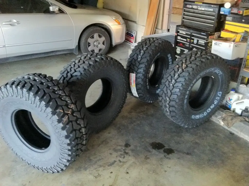

picked up my tires today, 33x12.5x15 Firestone Destination M/T's. These things are a lot bigger than I was expecting, I hope they fit well. I also got my spindles in the mail today. I was reading the instructions, and I didn't realize I had to modify anything, I am not really nervous about messing it up, I've done it before, it just worries me because I only have one day to do the work and I can't afford to screw anything up.
Anyways, heres some photos
Firestone credit card with 6 months no intrest :) 828.57
When I think of Firestones, I certainly don't think of kick ass tires like those. I think of boring run-of-the-mill tires. Those are nice.
These are supposed to be stronger and perform better than the bfg m/t's so we'll see. They are nice tires tho  I won't be able to install then for three weeks tho because I have no time :(
