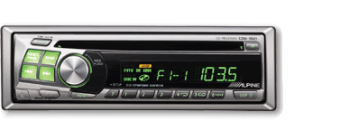

My system up to this point has been an alpine cdm-9821 h/u

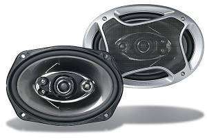

Pioneer TSA6992R 6x8 replacements for the factory speakers

So how should I go about this install, w/ the equipment shown in the pic of my first post. I do not want to return or check anything else out, product wise.
