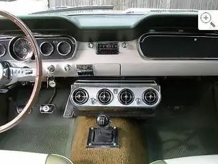

The best solution I've seen is an under dash "classic" a/c conversion. This way you can get rid of the factory air box completely. (except the heater core and fan for heat and defrost functions)
Vintage Air sells a complete kit; but you can just get the hoses and the under dash air box and use your existing compressor and condenser.
And they work better than the factory air. iccccy
A complete kit only runs $560.00. Also a cheap way to do a full a/c replacement when the factory junk goes, well junk end up....
