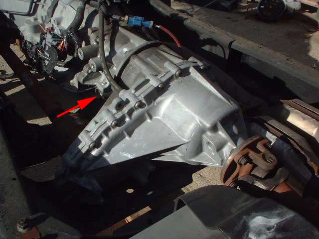

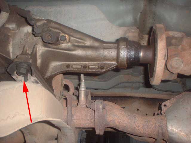

Here are some pics of my two setups. To me, it looks like the 4wd tailshaft + transfer case is a lot longer than just the 2wd housing. You can go off where the cross member bolts up to the tranny (the red arrows). What do you think?

Ya, you are right Section, looks about 5 - 6" longer with the T-Case than with the Tailshaft, that's kind of surprising.

Ok it looks like im in the market for a new driveshaft then. I have almost no tire rub with my 255/55 18's just a little on the sway bar and i have about 4.5'' of drop up front. Now turnign hard in reverse and hitting a bump it will rub on the top a little but it has kinda trimmed itself ha ha
