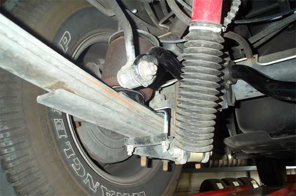

Here is a picture of the Air Lift system installed with the X-Spec Handling Package.
