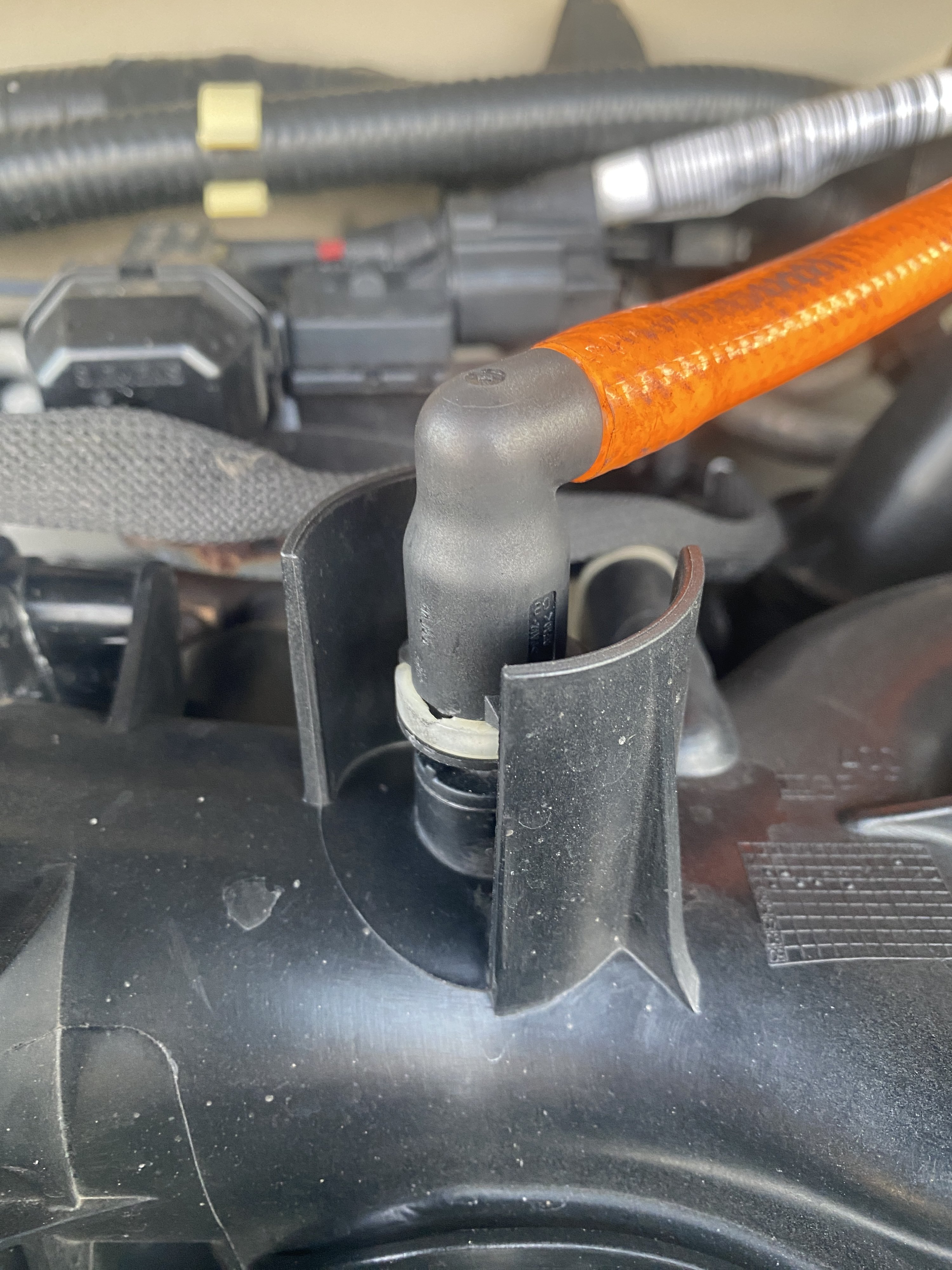

What hose is this ?
Anyone know what this hose is that plugs into the top of the intake?

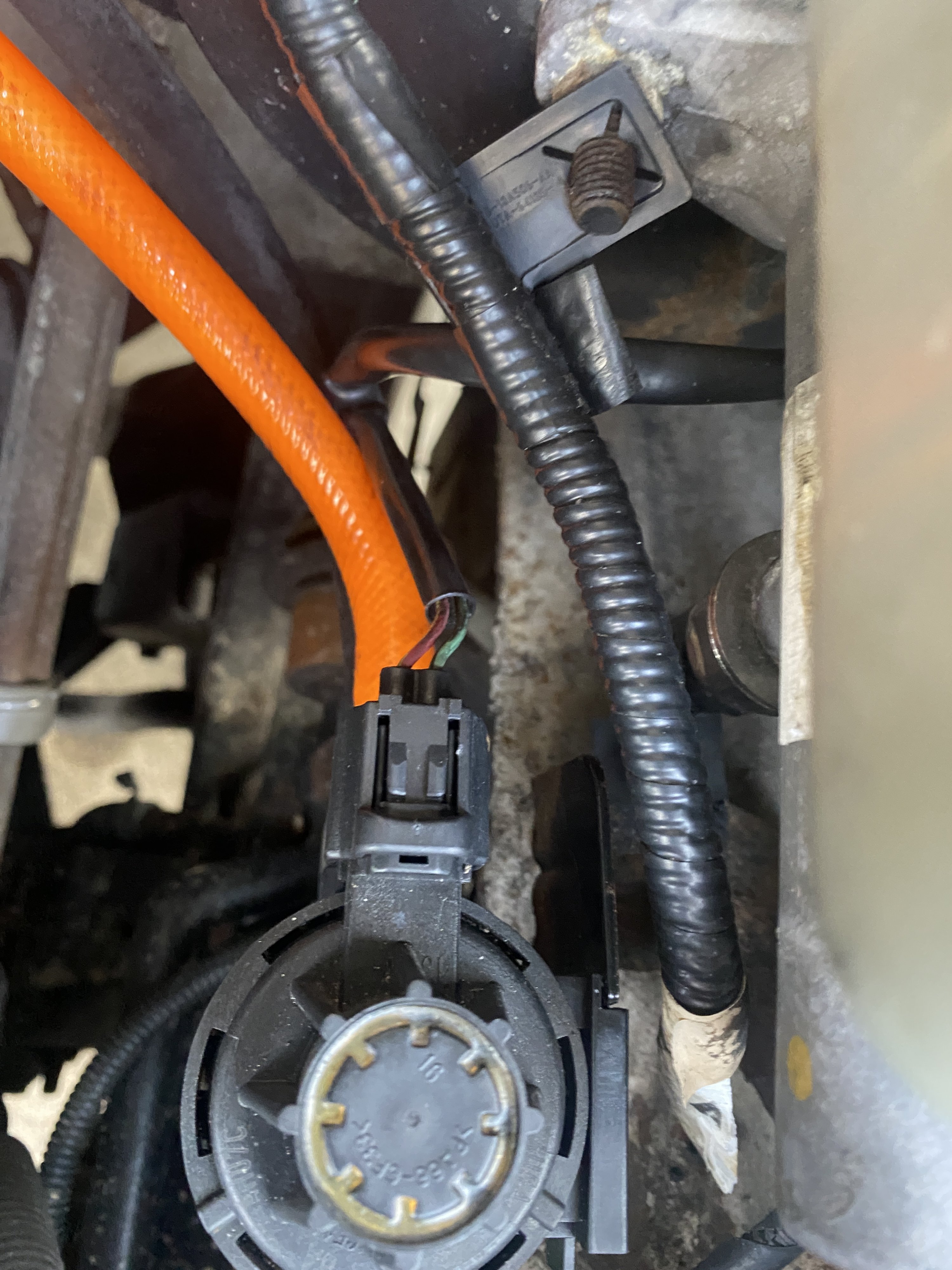

It’s part of the evap system. What’s the specific question? Do you want to know size so you can put a non-fuel injected gas hose on it?
Needs to be replaced yes. What do you mean by non fuel injected?
Emission related hoses are fuel lines. When you buy one, you don’t want one rated for fuel injection. It’s not needed, it’s a lot more rigid, harder to install.
It’s either 5/16 or 3/8” inner diameter.
the orange one wasnt strong enough wall thickness to not collapse....
