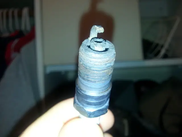

thanks Streetrod. I tested the spark on that cylinder and its sparking great. The plug indeed was fried. Black and the entire top was gone. I'll post a pic in morning. I went ahead and replaced all 3 sparks on that side of the engine tonight. I'll leave the wire as I have them switched already. If its the wire I assume my cylinder misfire will switch to another cylinder. I'll listen to the fuel injectors tomorrow although I suspect they are ok since I moved them all to other side a month a go and the dealer tested them with some sort of dye test and they checked out.

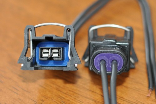

injector wiring
My stock injector electrical connectors easily broke when I disconnected them and were no longer reliable. I replaced them with connectors of a different design.
Let me know how those fit. Mine broke during removal on my 94. I didn't like the way the replacements looked vs OE. And Ford wants your first born, five times over, for OE replacements.
nice
Ya, I like those injector plugs much better. I know I have a broken one too. They were all brittle. I have some like that on my bmw and love them.

So, either a defective plug or oil fouling damaged it. Haven't seen oil fouling do that to a plug though.
detonation?
thinking maybe its because of overheating issue that seems solved. But it did overheat a couple times in last few months. Only affected this cylinder though. Weird.
That doesn't look like oil fouling to me. I think its from detonation due to lean condition. You stated in your original post that you had swapped the left and right bank injectors. The PCM fires the injectors by "grounding" the low side. There should be battery voltage on the hot side when the ignition is on. I suspect there is an electrical problem with the injector - either wiring or connector. Did the dealer test to determine if all of the injectors are firing?
