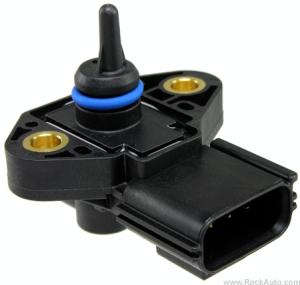

That relative injector flow test is very clever and a fairly accurate method. The 4th generation has a fuel pressure sensor on the fuel rail.

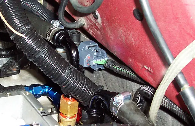

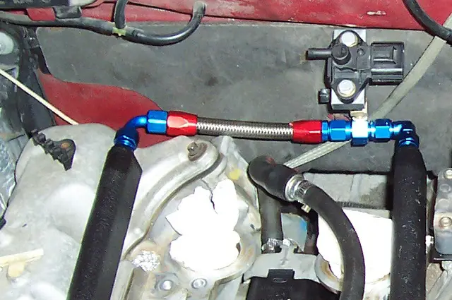

I installed one on my fuel rail when I added my M90 supercharger and my high flow fuel pump.
I ended up moving it from the driver side to the passenger side for wire loom clearance.

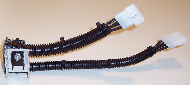

It's wired to a PWM fuel pump controller.
So I'm going to assume that all injectors are pulsing and flowing correctly. I'll have to spend some time coming up with an alternative explanation for your spark plug rapid erosion.
found it on internet

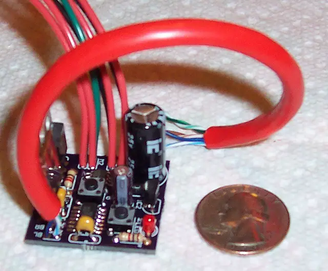

I can't take the credit for the PWM fuel pump controller. It was available as a kit or assembled online. I just happened to find it while searching for data on the fuel pressure sensor. Many years ago I would have purchased the kit and assembled it myself since I have a degree in electrical engineering. However, at the age of 68 my eyes are no longer good enough for detailed soldering so I bought it assembled and tested. It was designed for motorcycle and compact vehicle fuel pumps but with added heat sinks has been able to handle my Aeromotive Stealth 340 lph fuel pump.
