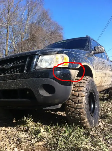

i bumped into my buddys ranger on accident, and my bumper on the passenger side got a little warped.. we just propped it back into place, and drilled a self tapping bolt into it. it holds stronger than the driver side now..
