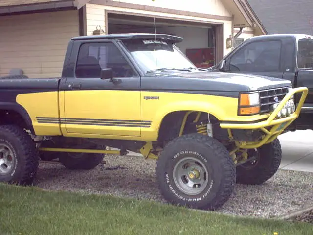

Well I thought I'd share this ranger with you other ranger fans. The owner and builder lives accross the street from my buddy. It has a list of mods that goes on for days and is more capible off road than a heavily modded TJ.

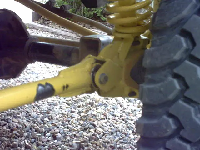

Just one of the very trick radius arms

That is definately a nice ranger...I like the solid axle up front.

This truck does extreamly well on all of the hardest trails in moab. The only problem that he has is those rear traction bars limit his travel and hang up on everything. I have suggested a solution to fix and he is going to try it.
I saw that Ranger in Moab. Takled to the owner for and invited him to the site. The raduis arm setup is sweet! Its hard to tell from the photos, but the right arm uses Johnny joints on both ends. The left arm has a fixed mount at the axle and a Johnny joint at the frame. The owner hadn't tested it when I was talking to him (he had only finished it the day before), but he did say that he was going to have trouble with the driveline due to the increased flex of the new suspension. The truck is running a EB Dana44, 9" combo with a 302, C-4, Dana20.
