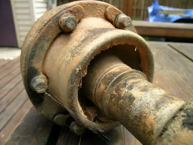

How does one go about removing the front drive shaft to the transfer case? Any photo or video explanation would be most appreciated.
Its just 6 bolts. They're small but very long bolts, I think like 10 mm heads.
Pardon the dirt, but here is the transfer case end of the front driveshaft and the bolts:
When removing the front driveshaft, dont pull on it along its rotational axis. Instead, if doesnt disconnect (in other words, fall off) the transfer case easily, tap the driveshaft with a hammer where the 6 bolts go into, not the soft rubber "boot" which the bolts surround.
Here is what the other side looks like:
