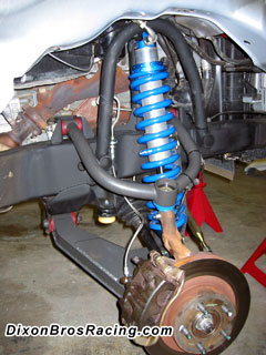

A spindle wont work for you, only for 2wd units. Where the spindle hub is, you have a cv shaft going through it.
You see?
Duh, I feel dumb...what are the options for 4X4 front independent suspention?
