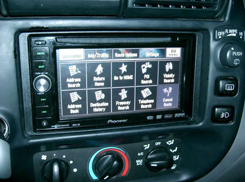

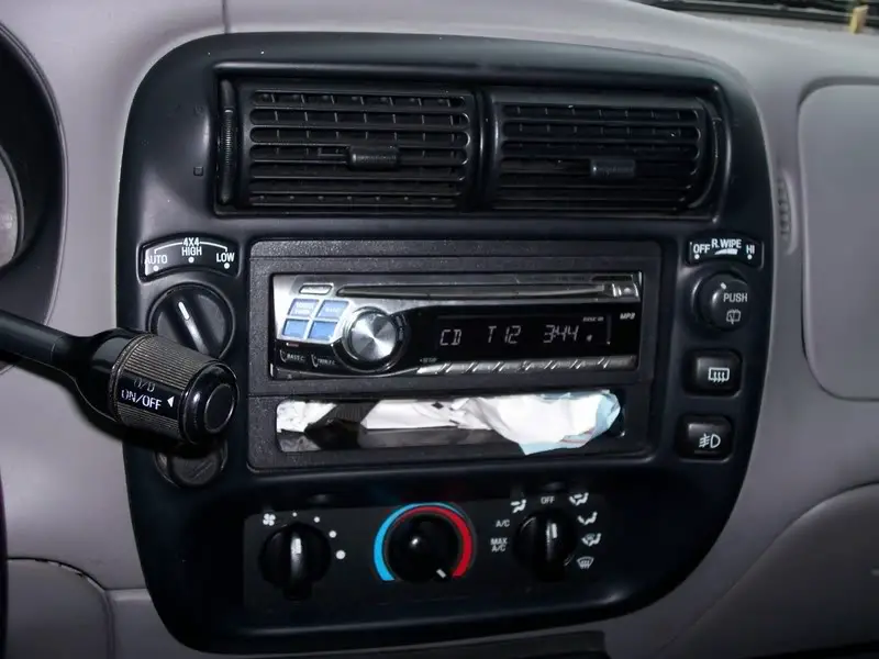

In all honesty.. I absolutely HATE how Explorers look with Single Din aftermarket radios.
It looks very out of place.
Whereas a double din looks much better..
How do those mount in there? I like how the ford radios have the 4 holes that release and lock it in place. I dont see them on those radios.
Also not sure what single and double din mean.
Single din is the first radio, it's a 180x50 mm panel, whereas double din is double that.. 180x100 mm panel.
They use special mounting kits, with metal brackets. They do not use the Ford 4 hole removal tool.

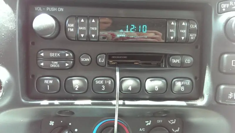

here is pic of what I got now.. Gonna be swapping it soon. Thing is its says CD on it, but there is no CD player.
Ahahah, you've got the exact same deck as me.
It's horrible.. CD is optional.
Have you tried a cassette head cleaner before swapping it out? It may not be worth it.

I haven't bought anything yet but was looking up the harnesses on the Metra website. But yeah when I mounted my double din on my other 97 Ex I had to dremel the corners a little bit for the mounting kit to fit and it's a pretty snug in there.
Yeah I am not going to modify the dash, so I am going with a bluetooth single din radio.
The prices are not as bad I as I thought and sure it cheaper than a new car..
The double din will fit with barely any modifications. You just have to sand off the little lip and it fits..
