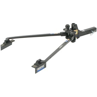

I own a 2003 Explorer V8, LTD with tow package. The tow hitch states max 3200kg (approx 7000lb) with electric brakes and "factory'" Ford Weight distribution bars.
My new enclosed car transporter and expensive payload weights 2800kg (6200lb?). I need to make sure I please the insurance company when towing, as I am sure if I do not stick to the factory specs, they would not pay out in a worse case scenario.
WHAT DO THE FACTORY FORD EXPLORER WEIGHT DISTRIBUTION BARS LOOK LIKE? Where can I buy them (US)
Has anyone got a photo they could share? What is the difference compared to aftermarket bars, however I am sure since it says "factory" Ford, thats what I need to use.

They never came with 'factory distribution bars', thats the load rating after you add aftermarket ones . . .
Weight distrbution bars look like this:
http://www.etrailer.com/pc-WD1~66041.htm

But it clearly says on the hitch label:
"3200kg with electric brakes and Ford distribution bars"
My hitch is different than the "lighter" hitch and has a plate that looks like it is to fit these bars. They must be "factory" distribution bars?

Ford does not build, or sell weight distributing hitches. For those, you have no choice to go aftermarket. I'd recomend http://www.equalizerhitch.com/
Sounds like you've got something connected to your hitch already, could you post a picture? This is what your receiever hitch should look like.
http://media.photobucket.com/image/explorer hitch/bdawg02/Explorer/1122081526.jpg
But the thing is the explorer is rated for 700 lbs. of tongue weight with the weight distributing hitch, or 500lbs. without. That is not very much, so be careful.

Our bar is a std bar, however mine is the NZ factory 7100LB hitch. It is similar, but it does not have the steel "loops". It has a plate above the hitch receiver with a hole either side. I will take a photo soon.
