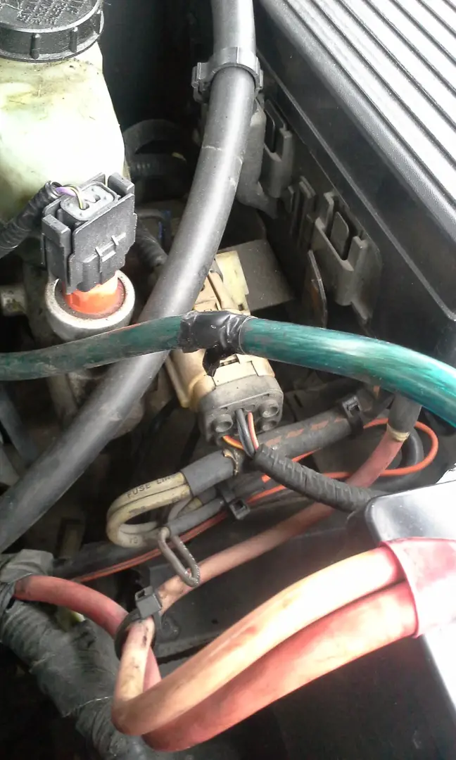

i think i found a someone elses wiring job...
is this factory or a custom wiring job????
Green wire is custom wiring job
Yea, that's not factory. Did u look into the grounds at seat and in the door hinge?
lol the green wire it 4 gauge wire to power amplifier......its supposed to be there for audio system....
