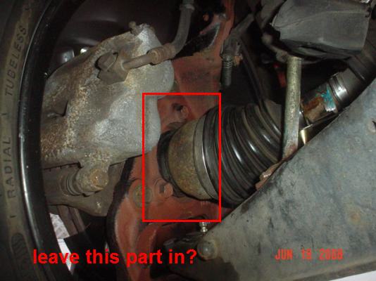

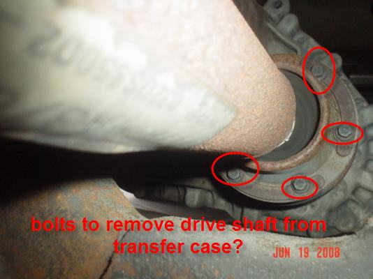

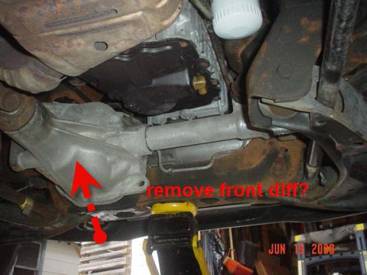

So I could basically remove what is shown here, correct?

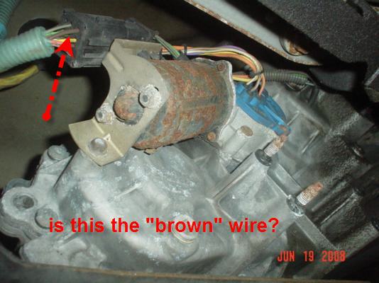

Is this the "Brown wire mod"?
Yes, but there's no need to clip it if you're removing the front half of the drivetrain.
And yes, everything you posted in the previous post was correct.
Wait. I thought that's the first thing to do according to Hartman?
At one point, I was without the front axle, front driveshaft, rear bumper (rollpan instead), and spare tire. My MPGs improved maybe .5mpg if that.
I thought it was required, but apparently it is not.
Only if he was going to keep the 4wd...
