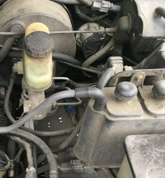

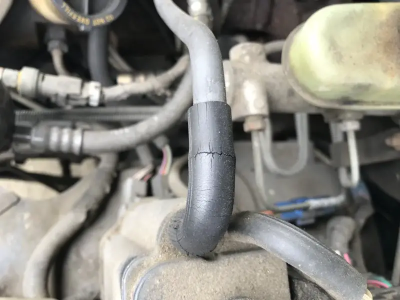

1994 Explorer - Can anyone tell me what this large hose is called and what it is attached to? It’s cracked as you can see so I need to replace it. Thanks. - Pam
Evaporation emissions hose. Looks like it connects to a charcoal canister. Any hose rated for fuel will work.
That piece is a formed 90 degree bend. I tried a piece of straight hose bent over but it didn’t work too well. My plan is a plastic 90 with 2 short pieces of hose on either end.
