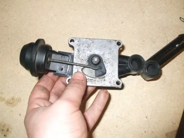

i have a 97 4.0sohc v6. under the black cover is the iac, what is the silver square bhind it do?, black cap that swings back and forth andis connected to a round diaphram thing in back? the black cap allways laying in square when i take off cover. what does this do? when i put the cap on the pole it seems to run better.

variable intake system
I think you're describing the variable intake system (VIS) actuator.
See VIS Conversion
yes thats it the black top pops off and lays in that groove area. what does this thing do? thanks
thanks didnt see link
You are missing a small e clip
does the e-clip go on top of post that holds black thing?
