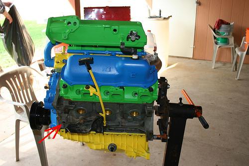

That looks like the oil level sending unit.. It on the side of the oil pan, not the transmission..
You can see it here on the side of the pan (lower big yellow thing :))

We didn't hook that up when we put in the rebuilt motor (the colorful one :)).. It turns on the check oil level light when your 2+ quarts low..
But.. looking at your pics, you have an oil leak and may need that sending unit to work..
Something tells me that its not a normal sending unit that you can easily pull from the outside.. I just can't remember, but I remember thinking "thats odd" when we were putting the pan on the block.. Just look into it before you buy the part.. (its NOT the oil PRESSURE sending unit.. which is what most places will try to sell you)

Where is the oil pressure sending unit (for the needle gauge) in that colorful pic? Mine's fried...
Mike
The oil pressure sending unit is screwed into a fitting that is screwed into the block.. I don't have the fitting installed in the pic above
I put an arrow on the pic pointing to where it would go..

Left side front of the engine, below the cylinder head in the engine block
