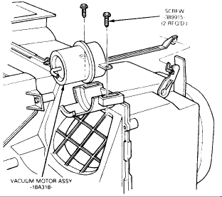

!! Hello Guys!!.....Can somebody tell me that it is this?...You find this appliance behind the glove compartment and it is cylindrical and has once some hoses were connected. Which is his objective?. I have attached some photos. :)
looks like a vac servo that controls a air intake door either for fresh air or recirclate door
This is it, isn't it? (Only it's laid flat in this diagram.)
AllData calls is the "Air Door Actuator / Motor".
I'm not sure if it's for the heat/cool blend door, to control where it flows out, or if it's for the "recycle" door.
Can anyone else add those details in?

Will it be that?
:)That is, is this appliance pertaining to the system of interior heating of the automobile?

i kid....been a un-eventfull day for me today .yes it looks like a temp blend door for the climate control system .:)
edit: like gloomis said "air door actuator servo" it's operated off of engine vac lines...if it dont work then there may be a leak in the vac line or the diaphram in the servo has developed a leak .
Since the lines of vacuum are mentioned... Will any account with control cruiser, since neither it works ?
