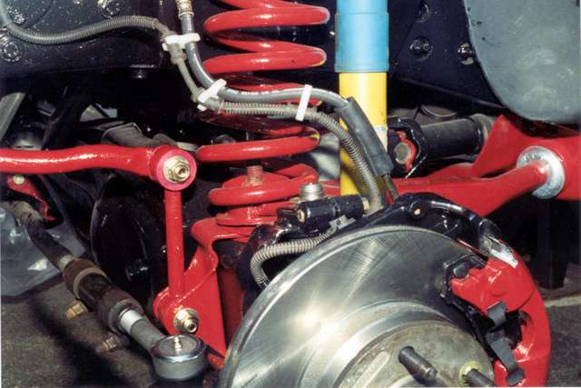

The sway bar bushing kit is very nice and I recommend it.. Unlike the stock end links the ES links (pictured below) have a wide contact area to prevent distortion. The tie rod part is just a boot cover and not an actual bushing (I would only change this If I had the tie rod off for some other reason).
