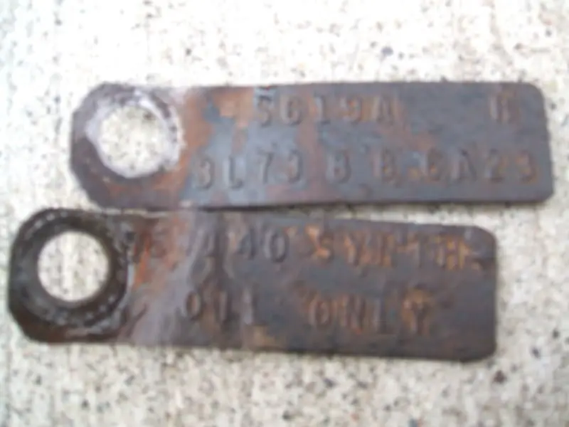

Heres a pic of the tags on the rear diff. Just wondering what gears and differential I have.
Also judging from the back differential is there any chance I have a LSD in the front? Or is it open?

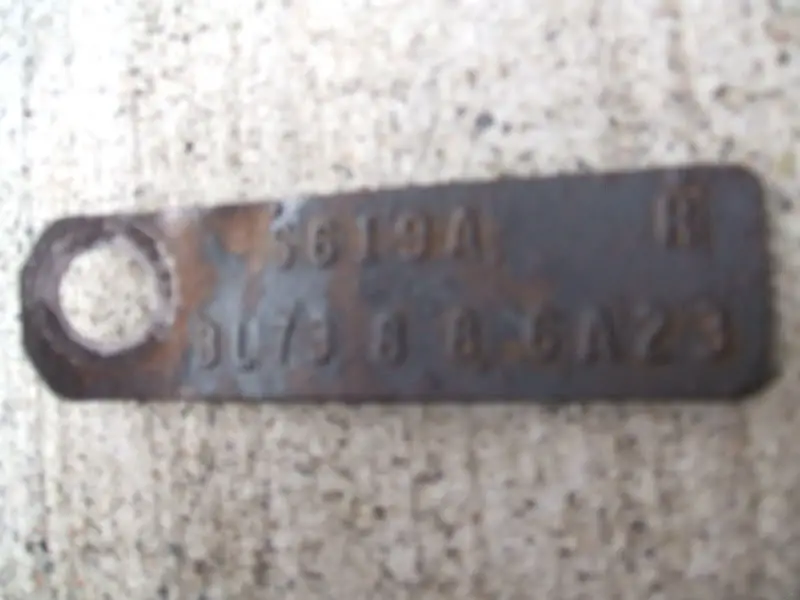

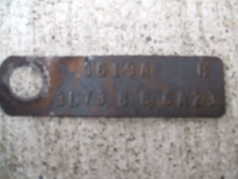

3.73 ratio - Ford 8.8 axle.
Anyone have any ideas on what the rest of the numbers on there mean?
L73 = Limited slip 3.73 gears
8 8 = 8.8 rear end
S619A - Explorer 96-97
3L73 - 3.73 Limited Slip
8 8 - 8.8" Ring Gear
6A - Build Date
23 - Plant Code
Do all AWDs come with the limited slip?
2nd tag reads 75W140 SYNTH OIL ONLY. I have a 95 with 3.73 LSD also and read diff info on weights/oils etc. All I had to do was climb underneath and read the tags.... Putting on a new diff cover soon and bought 75W90, will be purchasing 75W140 if that is what the tagger reads. Neat info, thanks for posting pics. Wonder why Ford recommends LSD modifier if they use synthetic. I dont believe Royal Purple or Amsoil recommend the need for the modifier when using their products. Happy Easter.
