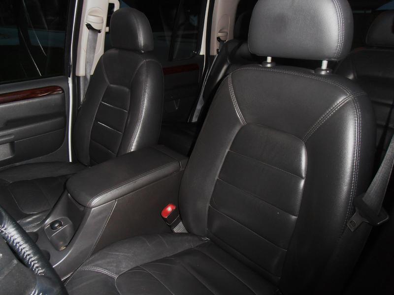

These are the Limited seats. Sort of in-between a really dark grey and black color. The flash probably makes them look a little lighter.

Yeah I like dark interior way more than light.
I'll probably slowly start picking up limited interior.
