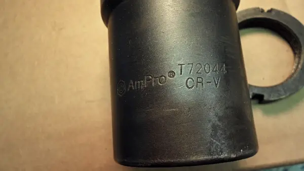

The one in the pic is for the d44 made by AmPro with the part number.
Glad I found this. I have the socket that slips off (all four prongs on top of the socket) every time I try to use it and I have been looking for the other socket that won't slip off (the four prongs inside the socket). Does the ampro style socket have the prongs inside?
Give me a minute, I'll go out and check.
Yes the socket has the prongs on the inside. The part that goes over the spindle is perfectly round and nothing protruding out. You have to look on the inside to see the prongs.
Could take pic if you like.
