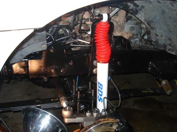

I used a Gen 1 box and Gen1 pressure line. I also re-used my IFS power steering cooler as well. I also have a hybrid Gen1 and Gen 2 steering shaft.
